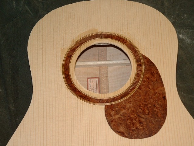

PostPosted: Wed Aug 30, 2006 11:39 am
Posts: 170
Thanks for all of the help.
I found my problem, the block I sliced for my first
try just don't like to stay flat. Grain problem.
Flat right off the saw, but as soon as I tried to
seal with shellac, they would curl.
Took a slice from a different block and it stays
flat, even after sealing with shellac.
It will work now, I love when I can blame the wood.
I rough cut the pickguard shape just to see how it
will look. What do you think?
Thanks Again!
Tom
http://www.moriciguitar.com
PostPosted: Wed Aug 30, 2006 12:16 pm
Now that's purty....
PostPosted: Wed Aug 30, 2006 2:50 pm
Purty indeed Tom!
PostPosted: Wed Aug 30, 2006 10:34 pm
Posts: 720
Hi Tom,
I REALLY like it ! Looks superb !
Regards Craig Lawrence
CRAIG LAWRENCE of AUSTRALIA
PostPosted: Thu Aug 31, 2006 12:00 am
Tom, I really like how it matches the rosette. That will make a great pickguard! Who need tortise when you have burlwood around?!
